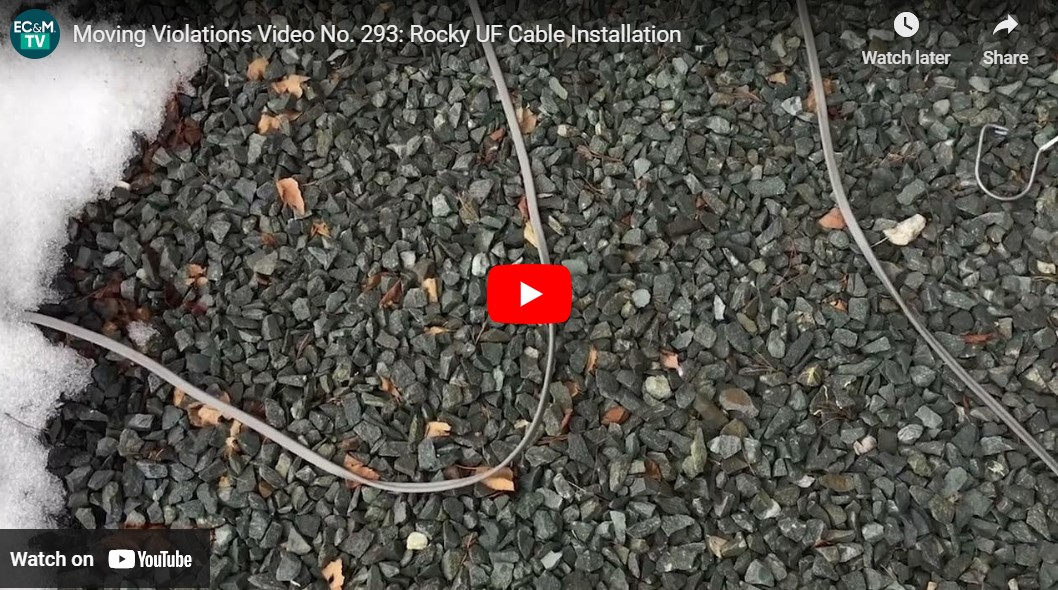

Russ finds a UF cable installed between some rocks, strewn about, and lying on top of gravel
In this episode, Russ finds a UF cable installed between some rocks, strewn about and lying on top of gravel. Section 340.12(10) does not permit UF cable to be used where subject to damage. Because the cable is lying on gravel where anyone can walk on it, it is a clear violation of that NEC requirement.
