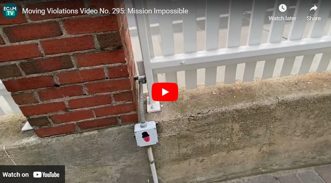

Russ examines some wiring inside of a conduit body that is impossible to reach.
In this episode, Russ examines some wiring inside of a conduit body that is impossible to reach. This installation is a violation of Sec. 314.29(A), which requires boxes and conduit bodies to be installed so that the wiring can be accessed without removing any part of the building or structure. In addition to that violation, the installer used some mixing and matching of wiring methods, which caused a violation of Sec. 356.42.
