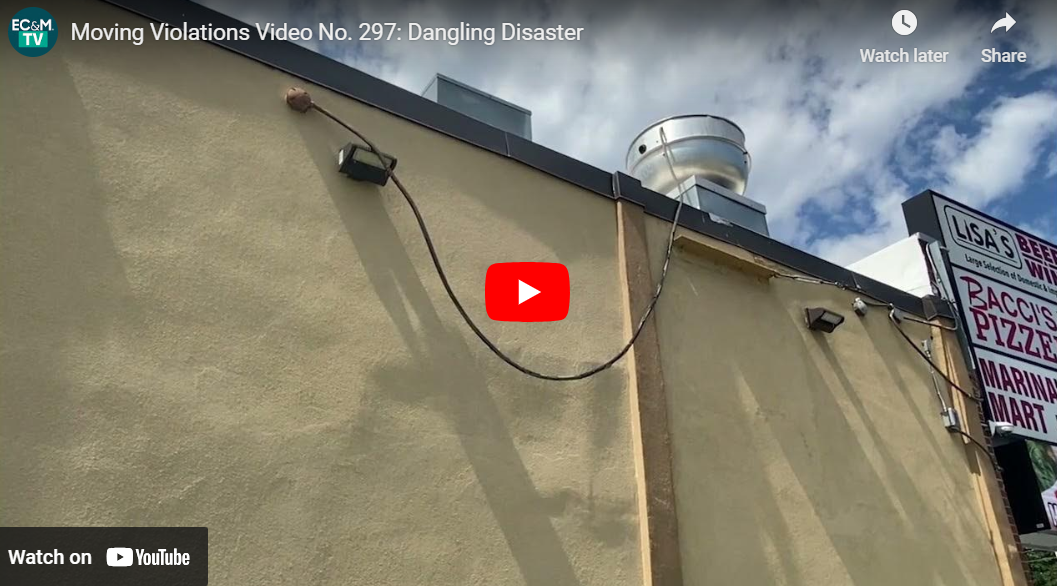

Moving Violations Video No. 297: Dangling Disaster
Russ comes across some LFMC dangling off the side of a building.
In this video, Russ comes across some LFMC dangling off the side of a building. There are no clips or straps supporting it, which is a violation of Sec. 350.30(A). Without proper support as required by the NEC, the dangling will put too much strain on the connectors and eventually lead to serious problems.
