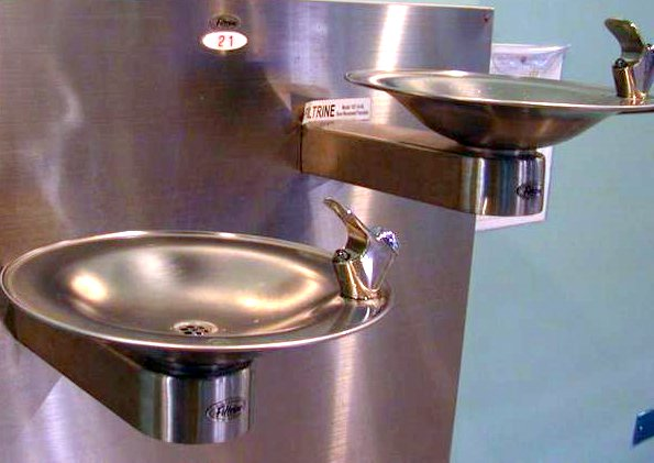

    2) People are getting small electric shocks at the water fountains. You met with the HR manager about this, and he said it’s a frequent complaint.

    The electric shocks indicate there is undesired current seeking a path back to the source. The fact the water fountains serve as this path means the facility has bonding deficiencies. Those deficiencies may also explain the equipment failure rate, especially if these are motor losses.
    Low power factor may explain the high electric bill; use a power analyzer to see what you’re dealing with. You can also use that power analyzer to determine the integrity of the neutrals; this may reveal where that undesired current is coming from.
