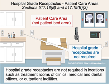

Q. Are hospital grade receptacles required in doctor, chiropractic, or dentist examination rooms? What about isolated ground receptacles?
A. Oh good! An easy one. No and No. Hospital grade receptacles are only required for patient bed locations, defined in 517.2 as an inpatient sleeping bed; or the bed or procedure table used in a critical patient care area (Figure at right).
Isolated ground receptacles, or receptacles that incorporate an isolated grounding connection intended for the reduction of electrical noise [250.146(D)], are never required by the NEC.
An isolated ground receptacle isn't actually isolated from the system ground. This type of device has its grounding contacts insulated from the metal mounting yoke. Art. 517 properly calls an “isolated ground receptacle” an “insulated ground receptacle.” In fact, the FPN to 517.16 cautions against the indiscriminate use of receptacles with insulated grounding terminals since such a practice forfeits the benefit of parallel grounding paths that otherwise would occur.
