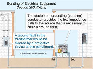

Q. I want to run 3/0 AWG triplex to a transformer located outdoors. Am I required to include a ground wire with the triplex even though the transformer is grounded to two ground rods?
A. Yes, an equipment grounding (bonding) conductor is required to be run to the transformer because it is needed to provide the low-impedance path to the source that is necessary to clear a ground fault [250.4(A)(3)] (Figure). Because the contact resistance to the earth via the ground rods is so high, very little ground-fault current would return to the electrical supply source via the earth. The result is the circuit overcurrent protection device will not open to clear a ground fault, and metal parts will remain energized.
