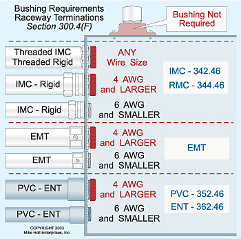

    Q. An inspector told me that insulating bushings are only required for raceways sized 1 in. or larger with the exceptions of IMC and rigid conduit. I can't find any reference to this in the NEC.
    A. According to 300.4(F), a fitting that provides a smoothly rounded insulating surface is required for raceways that contain ungrounded conductors 4 AWG or larger. The exception states that an insulating bushing isn't required where the raceway terminates with a threaded entry, such as a hub (Fig. 1).
