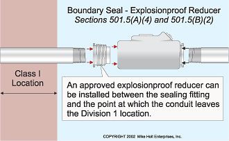

Can I install a reducing fitting at an explosionproof seal located just outside the boundary of a Class 1 Division I area?
A.
Yes, if it's a listed explosionproof reducer fitting. However, if the reducer is located after the seal, then the reducing fitting isn't required to be explosionproof listed [501.5(A)(4)] (Fig. 1).
