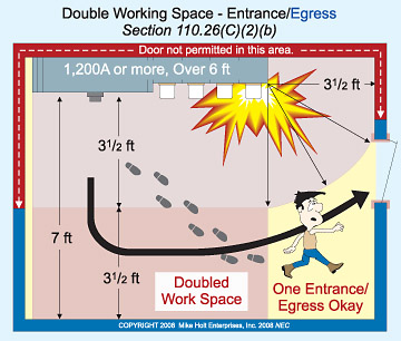

I have a 1,200A, 480V panel that has a working space of 3½ feet. The engineer says 7 feet is required. Is he correct?
All questions and answers are based on the 2008 NEC.
Q. I have a 1,200A, 480V panel that has a working space of 3½ feet. The engineer says 7 feet is required. Is he correct?
A. Maybe. The working space, which is measured from the enclosure front, must not be less than the distances contained in Table 110.26(A)(1). If you have grounded metal parts on the other side of the working space, you would need 3½ feet. If you have equipment 1,200A or greater, more than 6 feet wide, you also must have an entrance to/egress from the working space at each end of the working space [110.26(C)(2)]. If you have double the required work space (7 feet in this instance) a single entrance/egress is allowed, if it is located at least the required working space distance(3½ feet) from the equipment [110.26(C)(2)(b)] (see Figure).
