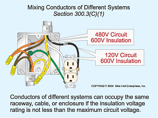

Q. Can 277V circuit conductors be placed within the same raceway with 120V circuit conductors?
A. Yes, power conductors of different systems can occupy the same raceway, cable, or enclosure if all conductors have an insulation voltage rating not less than the maximum circuit voltage [300.3(C)(1)] (Figure).
