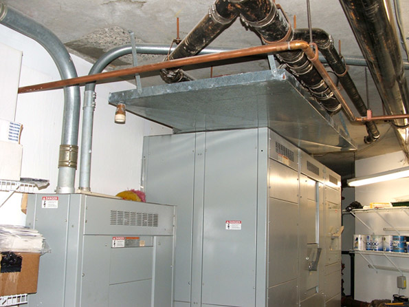

Look Out Below!
Section 110.26(E) requires that switchboards and panelboards be located in “dedicated spaces” and protected from damage.  The space that extends directly above the switchboards to the structural ceiling or a height of 6 ft above the equipment (whichever is lower) is dedicated to the electrical installation. No foreign piping or leak protection apparatus can be located in this space. The drip pan makes it impossible for an electrician to install any pipes into the top of the switchboard. In addition, take note of where the drip pan drains. I guess the small switchboard gets sacrificed in order to save the big switchboard from any water damage.
