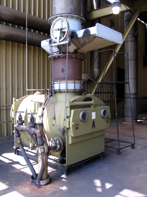

Though you can’t see the motor, this coal feeder won’t run without it. Among the many calculations Black
