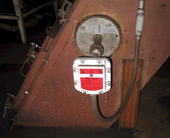

This is a plugged chute detector on a coal chute. Notice the coal dust near the base of the unit. The normal presence of ignitable dust makes this a Class II, Div. 1 location. If you look at the fitting, you’ll see it’s not explosion-proof.
