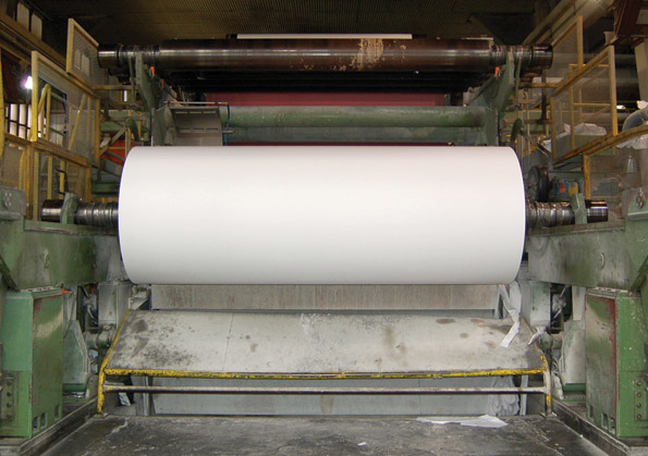

If there’s risk of fire or explosion due to the presence of combustible fibers, apply Art. 503.

Photo. This paper machine is a prime example of a Class III location, due to the presence of pulp fibers.
