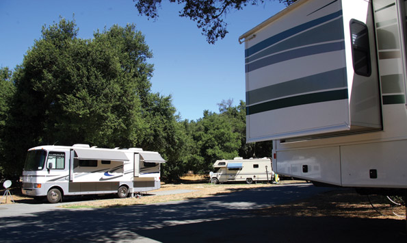

An “RV site” is a plot of ground set up to accommodate one RV [551.2]. Each site must have at least one 20A, 125V receptacle [551.71].
In any given RV park, at least:
• 20% of sites must also have a 50A, 125/250V receptacle that conforms to 551.46(C).
• 70% of sites must also have a 30A, 125V receptacle that conforms to 551.46(C).
And the remainder of the sites must have one or more of the receptacle configurations conforming to 551.81. Also:
• 125V, 15A and 20A receptacles must be GFCI-protected [551.71].
• 125V, 20A and 30A receptacles can be supplied by any grounded system that supplies 120V single-phase power [551.72].
• Each 50A receptacle must be on its own branch circuit (the rating of which must match the rating of the receptacle) [551.72].
