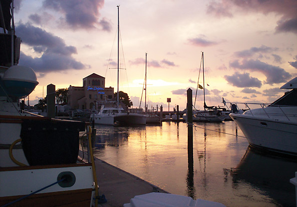

Unless the installation is a small dock for a private residence, it’s probably covered by the requirements set forth in this Article (Photo 1).

Photo 1. Boating is a popular activity all over the country, and many people tend to dock their boats at a marina — whether in this Florida marina, one of the 10,000 lakes of Minnesota, the San Francisco Bay, or the Boston Harbor (Photo courtesy of Lynnette Lamendola).
