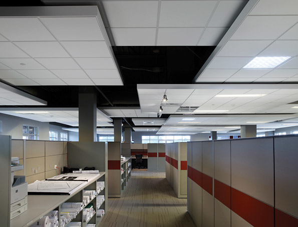

Photo 1. The offices of Optima Engineering, Charlotte, N.C., have an interesting look, thanks to a CPDS. The system makes for such a neat installation that even with the large ceiling space areas open to view from below, you can’t see the wiring (Photo courtesy of Nextek Power Systems).
That’s pretty much what low-voltage system installers were working with prior to the advent of the CPDS. With this analogy, you can understand the many problems a CPDS solves in terms of installation, troubleshooting, repair, and maintenance. And, of course, it makes for a much neater installation at a lower cost (Photo 1).
