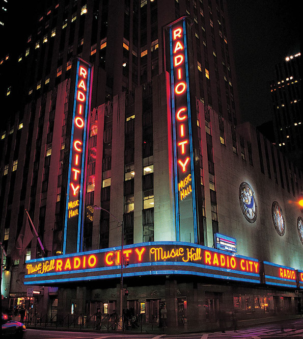

The types of locations covered by Art. 520 (Photo) tend to make extensive use of portable equipment. You can use approved flexible cords and cables for portable switchboards and other portable equipment [520.5(B)]. This requirement is a fork in the road. Take one fork, and you’re dealing with requirements for portable switchboards. Take the other, and it’s portable equipment. Taking that first fork, we go to Part V.
The iconic Radio City Music Hall is an example of where Art. 520 requirements must be applied. Edwin S. Kramer of Radio City Music Hall is a representative to the International Alliance of Theatrical Stage Employees and served on the Code-Making Panel for this Article (Photo courtesy of Radio City Music Hall and MSG Entertainment, New York City, N.Y.).
