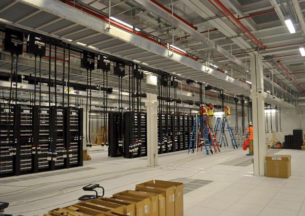

Photo 1. Centercore modular data center being built in Omaha, Neb.
5) The new Art. 646 Modular Data Centers (MDCs) validates the increasing popularity and industry acceptance of MDCs (Photo 1). While many of the same rules can be found in other sections of the NEC, the information is now consolidated, providing users with a single reference point as well as a forum for future expansion. Article 646 will continue to evolve in the upcoming Code cycles as the MDC industry further develops.

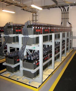

Article 480: Storage Batteries
UPS systems often use stationary storage battery systems to maintain power to critical IT equipment for the brief period of time when both electric utility and generator power sources are unavailable. There are different battery technologies on the market; the most commonly used in data centers are vented type (flooded wet cell) or sealed type (valve-regulated). Many batteries emit hydrogen gas during normal charging cycles — vented batteries more than sealed batteries. To coordinate with building and fire safety codes, Sec. 480.9 requires provisions “appropriate to the battery technology” be employed to prevent the accumulation of explosive or otherwise harmful gasses.
Photo 3. Example of a vented lead-acid battery setup in a data center.
Battery installations must comply with 480.9(C), which references 110.27 for guarding of live parts. Minimum clearances are indicated. Additional clearances should be considered to enable access for rigging equipment used during future battery replacements (Photo 3). Battery rooms may also contain emergency showers, eye washes, and spill containment, all of which should not encroach on the dedicated equipment and working spaces.

Article 646: Modular Data Centers
Article 646 is one of four new Articles added to the 2014 NEC. The others are Art. 393 (Low-Voltage Suspended Ceiling Power Distribution Systems), Art. 728 (Fire Resistive Cable Systems), and Art. 750 (Energy Management Systems).
Modular Data Centers (MDCs), or “containerized” data centers, represent a growing trend in data center architecture. MDCs are prefabricated units rated 600V or less, which are preassembled at a factory and shipped to the construction site. An MDC may consist of one module that contains ITE and all supporting power and cooling equipment, or it may consist of multiple interconnected modules with the ITE separated from the supporting power and cooling equipment.
MDCs offer several advantages over traditional “stick-built” data centers. They are constructed off-site in controlled environments and can be shipped nearly anywhere in the world, enabling accelerated project deliveries and reducing project risk due to weather or other unforeseen site conditions. MDCs are inherently scalable and provide greater flexibility with nearly unlimited load-on-demand opportunities.
MDCs may be listed and labeled, in which case, all factory-installed equipment and wiring would be certified under the listing procedures. Listed MDCs are only required to comply with certain sections under Art. 646; however, any field-installed components would be subject to full NEC compliance. The UL 2755, Outline of Investigation for Modular Data Centers, is one way to identify specific listing requirements. MDCs that are not listed must comply fully with Art. 646.
MDCs are permitted to use the alternate, less stringent wiring methods in Art. 645 [646.3(L)]. An approved disconnecting means (i.e., EPO) is required to disconnect power to all electronic equipment and dedicated HVAC systems [646.3(N)]. A nameplate is also required on each MDC enclosure that identifies the information listed in Sec. 646.5 and includes the full load current. The supply conductors shall be sized at not less than 125% of the full load current listed on the nameplate.
Flexible power cords and cables that are listed for extra-hard usage are permitted to be used for interconnecting separate MDC enclosures [646.9(A)]. However, they may not be used for connecting an MDC to an external power source, such as a building electric service [646.9(B)].
Workspace requirements for MDCs must comply with Sec. 110.26, which is the same for all traditional data centers [646.18]. MDCs containing equipment greater than 6-ft-wide or deep require one entrance to, and egress from, the working space (i.e., two doors), regardless of the ampere rating of the equipment [646.19]. Workspace requirements also apply to low-voltage circuits rated above 30Vrms, 42Vpeak, or 60VDC [646.20].
