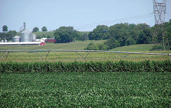

These machines may be in direct contact with the soil (Photo 1) or they may travel across it on rubber tires (Photo 2). In either case, their conditions of operation mean you really do ground them per the Art. 100 definition of grounding. See what other differences you can spot as we look a little more closely at the requirements of Art. 675.
Photo 1. This machine can be moved, but it doesn’t travel across the soil during normal operation. Due to its height in relation to surrounding objects, this machine is de facto a lightning rod. Though its metallic structure directly touches the soil, that’s not an adequate grounding means (thus, the Art. 675 grounding requirements).

Photo 2. This irrigation machine travels across the soil. It’s supported on rubber tires, creating a difference of potential between it and the soil. Proper grounding eliminates that. You can see the emitters on the top of the water supply piping of this irrigation machine (also on the one in the first photo). These machines operate about 50 miles from each other along the Ronald Reagan Memorial Highway in northern Illinois.
