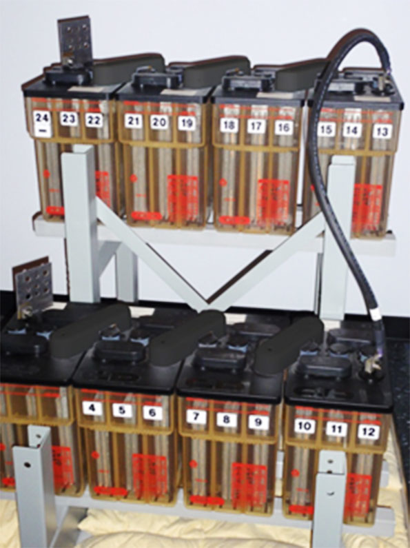

This is a good example of a typical rack-mounted, flooded-cell battery bank. Photo courtesy of C

Most plants place their batteries in ventilated PMMA (Plexiglas) enclosures to give personnel some protection from the battery terminals. Sometimes, the PMMA enclosure is vented to the room. Other times, there may be an exhaust fan to the outdoors. The enclosure offers protection from inadvertently touching the live parts. But just because you may only have qualified personnel in the substation, this doesn’t mean that someone couldn’t accidentally drop a tool on the batteries or touch the energized parts. There’s also the chance of an unqualified person ignoring the warning sign and entering the substation. So some sort of protective, ventilated enclosure is always recommended where the batteries are capable of coming in contact with personnel.
Adequate illumination must also be provided around these battery banks. Most substations have emergency lighting that automatically kicks on when the normal power feed is lost. While the emergency feature isn’t a requirement in Sec. 480.9, it is a great idea to provide this safety component where live parts are exposed.
One oft violated Section of the NEC is 480.9(C). The working space from the front of the batteries should be measured from the farthest protrusion from the battery equipment. Most of the time this will be the battery drip pan located beneath the battery racks — or possibly the battery racks themselves. The pan typically protrudes in front of the rack and on the sides, where the batteries are mounted against a wall. In large substations, the batteries may be out in the middle of the floor with the pan protruding all the way around the battery rack. Erroneously, the measurements for the required working space about the batteries are many times taken from the terminals of the batteries.
