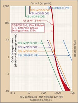

Figure 1 (click here for a PDF version) shows an example in which an outdoor transformer feeds multiple buildings with multiple secondary feeders. For this particular design arrangement, assume the system meets the requirements in Table 430.3(A) and Sec. 240.21(C)(4). Thus, no OCPD is required at the transformer secondary.
Concern No. 1 — Lack of an OCPD on the transformer secondary may make it difficult to coordinate overcurrent protection for the power distribution system. In this example, any single fault on a secondary feeder may trip the primary fuse. This would result in a power outage for all buildings fed by this transformer.
Concern No. 2 — While other subsections of 240.21(C) include requirements for secondary conductors, subsection (4) does not list a minimum cable size for outside secondary conductors. [Even the primary protection is not considered to protect the secondary feeder from Sec. 240.4(F) — although it may protect the feeder anyway, especially at high fault current (short circuit) range, due to omission of the secondary protection.] However, if the secondary feeder is sized relatively small, for example 1/0 AWG cable for Building No. 1 in the example, the cable-rated allowable short circuit current from the Insulated Cable Engineers Association (ICEA) might be less than the available fault current at the cable. When looking at time-current characteristic curves (TCC) on a log-log graph, the cable damage curve needs to be to the right of the OCPD tripping curve so it can be protected by the OCPD. As shown in Fig. 2, the cable damage curve for the 1/0 AWG cable is on the left of the primary fuse tripping curve. This means the cable is not protected by the fuse, and its insulation may be damaged before the fuse clears the fault.
Concern No. 3 — Lack of overcurrent protection at the transformer secondary may delay the process of clearing an arc fault, because the primary OCPD may not be sensitive enough to see it right away. This means that an electrician working on the secondary side of the transformer would be required to use a greater level of personal protective equipment (PPE). Arc flash calculation results are noted in Fig. 1 at each bus. PPE level 0 is required at the primary side of the transformer. However, the PPE category is “dangerous” at the secondary side of the transformer. Annex B in IEEE Standard 1584 states that “two seconds is a reasonable maximum time for (arc flash) calculations.” A clearing time of more than two seconds is observed for the primary fuse in the example.
Concern No. 4 — We may be able to save some costs by omitting the OCPD at the transformer secondary. However, due to the fact that the next-size-up rule can’t be used with the application of Sec. 240.21(C)(4), this might require you to increase the size of the secondary conductor. Cost analysis is required to compare the savings from the omitted OCPD with the extra cost from the larger feeder.
Concern No. 5 — Section 240.21(C)(4) does not list a maximum number of outside secondary conductors that can be connected to the transformer secondary when secondary conductor overcurrent protection is not required. Although Note No. 2 of Tables 450.3(A) and 450.3(B) requires no more than six OCPDs (i.e., breakers or fuses) grouped in one location as transformer secondary protection, Sec. 240.21(C)(4) doesn’t have a specific requirement for the number of secondary conductors to connect to the transformer secondary without protection. It can be unlimited.
