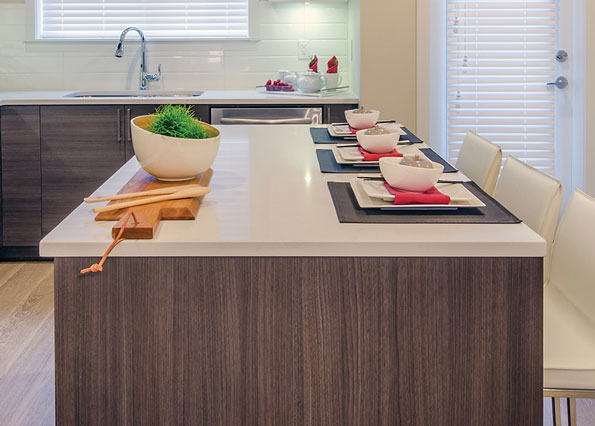

Something is missing on this kitchen island. Can you identify what it is? (ppa5/Thinkstock)
Among the violations he frequently sees, many concern Sec. 210.52 on Dwelling Unit Receptacle Outlets, particularly in kitchens. As 210.52(C)(2) stipulates, an island countertop space that’s at least 2 feet by 1 foot must have at least one receptacle to reduce the use of extension cords. But oftentimes, he’ll walk into a space and find those island outlets missing (Photo). “Usually these kitchens have very beautiful cabinetry, so no one wants to cut into or damage it,” he says. “The architect or interior decorator +isn’t thinking through the Code. They’re only thinking about what’s aesthetically pleasing.”
