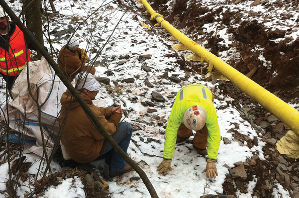

Freeze protection (Photo 1) is what most people think of first, but many heat-tracing systems are not for freeze protection. The applications are numerous. For example, the system’s job may be to maintain fluid temperature to lower the viscosity for better flow (Photo 2).
Photo 1. This pipeline is being installed on a hill in Tawanda, Pa. Freeze protection is required; notice the snow (Photo courtesy of Cody Anderson, Sedro-Wooley, Wash.).
