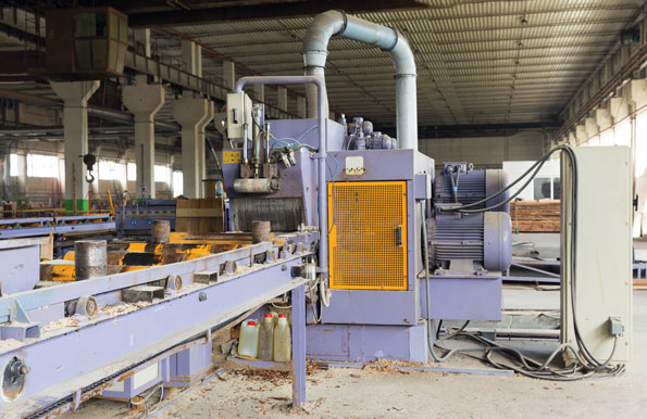

Walk into almost any industrial facility, and an hour later you can walk back out with a list of Code violations. How many can you spot in your facility? We’ll look at some common Code violations, why they matter, and what requirement(s) they violate. The first one on our list is arguably the most common.

Field modifications to older equipment can easily lead to electrical code violations (ET1972/iStock/Thinkstock).

Unused openings must be closed in a manner that provides protection substantially similar to that of the enclosure wall in which the opening exists [110.12(A)]. This requirement rules out some materials that are sometimes used to close the openings.
