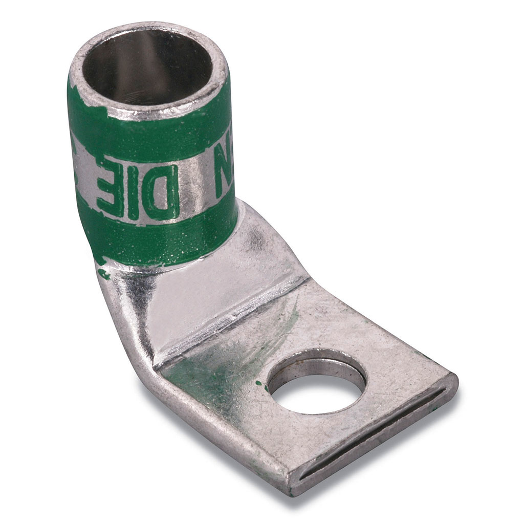

Example No. 2
The calculated minimum ampacity of a conductor is 1,000A. Type XHHW-2, 600V, copper wire is being used on this circuit. The cables will be parallel, two conductors per phase. The cables are installed in cable tray and comply with the requirements of Sec. 392.80(A)(2)(c). So, we can use the ampacity values found in Table 310.15(B)(17).
The 1,000A breaker has 90°C rated bus-type terminals on the breaker and 90°C rated compression lugs on the cable, so this termination is rated for 90°C. But, keep in mind that even though we initially thought we were allowed to use Table 310.15(B)(17), we’re limited to the ampacities of Table 310.15(B)(16) for the breaker terminals.
Using Table 310.15(B)(17) alone, it looks like we could use two, parallel, 300kcmil conductors per phase, which would give us the 1,000A of ampacity that we need. Now, we look at Table 310.15(B)(16) values for the breaker because we must follow the requirements of Sec. 110.14(C)(1). We find that to get a rating of 500A per conductor (1,000A for the combination of the two parallel conductors), we’d have to use a minimum of 700kcmil per each conductor. That’s a huge difference from the parallel 300kcmil wire that we initially thought we could use.
Lesson of the day
Always remember to keep the restrictions of the terminal temperature ratings in mind when sizing conductors. Not doing so could result in a very expensive mistake. There are very few cases where the high ampacities of Table 310.15(B)(17) can be utilized because all wire has to be terminated at some point. There are also very few instances where the 90°C column of Table 310.15(B)(16) can be used for anything other than ambient temperature adjustments or derating due to limitations of the terminals.
