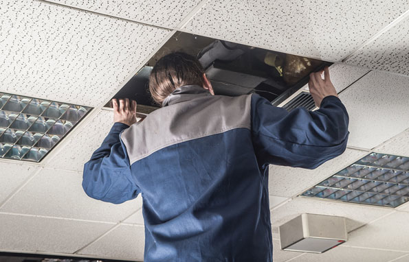

You can often find a variety of NEC violations in the suspended ceiling space of commercial buildings (Miha9000/iStock/Thinkstock).

Ceiling power
Technology changes often lead to reconfiguration work (or complicate new construction). For example, think about power distribution for low-voltage devices mounted in the ceiling. Years ago, the number of such devices was usually small. Wiring in one or two wasn’t challenging. Today, however, we have dramatically more devices being specified for new and existing buildings. This can make it challenging to do a good wiring job, especially if you’re mounting individual Class 2 power supplies all over the ceiling space.
Manufacturers responded to this problem by providing “box” systems that simplify the job. The NEC responded by providing Art. 393, so installations would be safe.
Related
You can’t just set the box on top of the ceiling tiles. It must be mounted securely to the mounting surface of the building structure [393.30(A)]. Not only that, but the individual power grid rails must also be mechanically secured to the overall ceiling grid assembly [393.30(B)].
Grounding and bonding are two sources of confusion with these systems. You do connect the supply side of the Class 2 power source to an equipment grounding conductor (EGC) [393.60(A)]. You don’t connect the load side circuits to the EGC [393.60(B)].
The boxes are the core of a plug and receptacle system. You’re not running individual conductors that you must strip and terminate at each end. You’re running a cable that plugs into the box. A consortium of manufacturers makes devices that are compatible with this system. If you have a device that’s not compatible, should you make an opening in the box to accommodate it? No, because that violates the listing for the box. Replace the device with a compatible one, or install a separate power supply for it.
