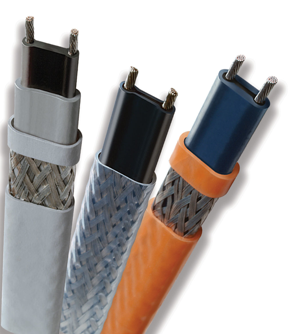

Self-regulating cables are a parallel type heating system that employs a dielectric material extruded between two conductors. As the temperature falls, the dielectric allows more current to flow between the two conductors, thus allowing more I2R heating to be produced. As the temperature gets warmer, the current flow lessens, which allows the cable to cool — thus, the name “self-regulating.” Self-regulating cables are typically used on low- to mid-temperature systems, relatively speaking.
