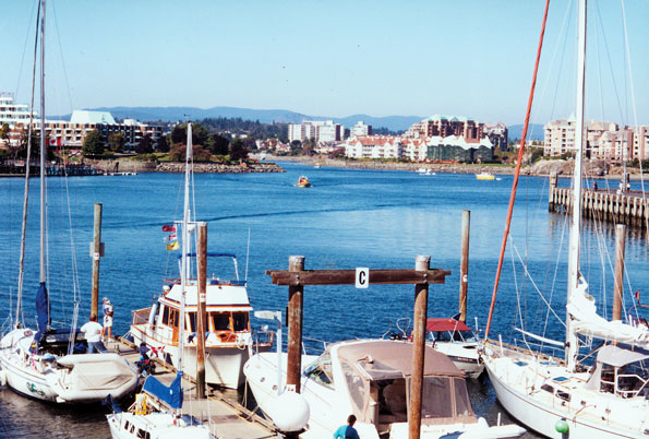

The electrical installations at one marina in West Palm Beach, Fla., looked great at the piers. But it seemed like everything on shore was done wrong, and this problem existed on the long boardwalks to the piers.
A simple grounding or bonding error can quickly turn a beautiful setting like this into the scene of a tragedy (photo courtesy of Gloria Johnson).
Along the boardwalks, none of the ENT raceway was supported between junction boxes [362.30, 300.18]. It sagged so badly that it came apart, exposing  conductors. ENT is not permitted in this location due to the constant exposure to sunlight [362.12] unless listed for this use. This ENT wasn’t so listed.
Clearly, the marina owner hired a qualified electrician for the “near the water” work (which complied with Art. 555). But whoever did the work for everything else seemed to be Code-defiant. Two violations in particular were rampant (the requirements aren’t in Art. 555):
• Poor workmanship [110.12]. The boxes and receptacles were at random heights. Raceway was run at varying heights, producing a serpentine appearance.
• Portable cords were cable-tied to the exterior walls of the snack bar and equipment rental buildings [400.8]. Not one was marked with a “W” (listed as Weather/Water resistant); many were just strewn along walkways.

Forensic reports reveal that many electrocutions near water wouldn’t have happened if proper bonding and grounding had been done. Article 555 starts its bonding and grounding requirements by saying to apply Art. 250 [555.15(A)]. The second requirement is to also apply 555.15(A) through (E).
Other than one specific caution, we won’t summarize Art. 250 in this article. But using Figure 250.1 will help you correctly apply it.
The caution is about the same confusion existing with these installations that exists generally. Installers drive separate ground rods for different systems but fail to bond them. This practice results in dangerous differences of potential. Make sure all of the utility (gas, electric, etc.) ground rods are bonded.
To comply with Art. 250, connect the various ground rods with a suitable bonding jumper installed with listed clamps. If you use a good-sized (e.g., 4 AWG) bare copper solid conductor buried at sufficient depth, it will serve as a good additional grounding electrode while also connecting those ground rods.
