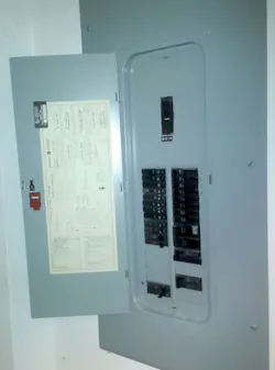

The undecipherable directory
This is a common and annoying Code violation. Often, the directory is useless.
Here’s an actual example from a recent repair job. A house in Florida needed a failed GFCI receptacle replaced in the kitchen. It’s a big kitchen with three receptacle circuits over the countertops alone. In the panel, the electrician found five breakers labeled “kitchen.” The homeowner didn’t want to reset clocks that were plugged into two of those circuits. The electrician was left to guess which breaker to turn off.
Photo 1. The vertical space for labeling a breaker in this panel is less than half the height of a 20A breaker.
Living room, bedroom, basement, and garage are labels that are often duplicated, regardless of how many circuits are in the living room, etc. Many miscellaneous circuits don’t get labeled at all, with the fire detector circuit being a common victim. Then there’s the totally useless label, “receptacle.” You get the idea.
The directories themselves are partly to blame; there’s not much room to write a description because each space is really tiny (Photo 1). And the typical electrician is beyond the age of reading something written there without reading glasses, if even then.
Another factor is that the residential electrician may “wing it” and pull a circuit to whatever breaker he chooses.
One solution to both problems is a standard plan for panel layout. This plan shows which circuits go to which breakers. It should be the same for each floor plan in a development. Instead of forcing electricians to write in by hand, print a big sticker that can be placed over the existing area where the panel directory goes (or more space, if it’s available). The breaker for a given circuit is determined by that sticker (rather than labeling after the circuit is terminated). No handwriting is needed, and you can easily fit a good description into the allotted space.
That the NEC should even have to require the directory to be useful [110.22] is a bit of a mind-bender. But it does. So make each label clear enough that anyone looking at it can tell exactly which circuit it disconnects.
A final note: Suppose you have three bedrooms — one for the parents and one for each of two children. If you labeled the breaker for Debbie’s bedroom “Debbie’s bedroom” it would be clear which circuit that is, right? Not if they sell the house, and five years later nobody has any idea who Debbie is or which room was hers. Don’t use transitory information to describe a circuit [408.4]. “Bedroom, northeast corner” is much better.

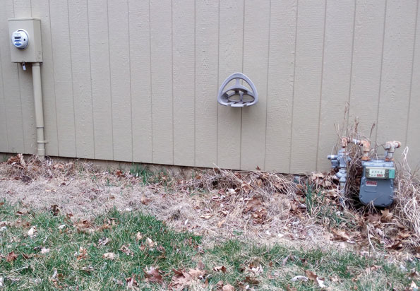

Ground rod bingo
Which utility ground rod is really ground? How do you know? Each utility company provides its own hookups. But it also provides its own ground rods, and these typically aren’t tied together.
Photo 2. This gas meter is at a different potential from the water main and the electric service. This house already burned down once. That’s not enough?
The result is these systems are at different potentials from each other (Photo 2 and Photo 3). This result presents dangers of lethal shock and damage to equipment in the home. In cases where the home also has a natural gas supply, the flashover that can result from the difference in potential between the gas piping and another utility can spark an explosion.
Photo 3. This is a different house, one street over from the “charcoal version” one. Notice the grounding clamp; there is one on each utility’s separate ground rod and on the gas meter frame, permitting a 4 AWG copper bonding jumper to bring all to the same potential.
Who is responsible for bonding all these rods together, thus eliminating dangerous differences in potential? Anyone who installs a system that has a ground rod should bond that ground rod to the existing grounding system. Yet, this almost never happens. If you’re the electrician on the job, make sure these get bonded together [250.94].
