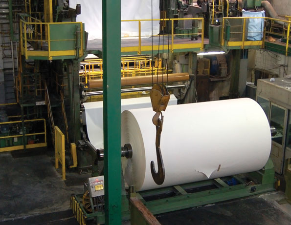

The goal of these restrictions is to keep fibers out of motors. Failure to do that is an NEC concern because of combustion risks. For the designer, it’s a reliability concern regardless of what the NEC says. Fibers/flyings can accumulate in the vents and choke off the air supply, causing the motor to shut down and production to stop.
The vent-clogging problem from using an unsuitable (and Code-violating) motor occurred in a paper plant. Rather than replace the motor, they installed a bottom-vented sheet metal guard around it. This was relatively inexpensive, but still not Code-compliant. And fibers still got in.
