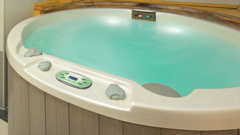

Per Sec. 680.43(D), there is a list of five items that need to be bonded together. The first four are relatively easy to understand, but that fifth item can be confusing. It states, “Electrical devices and controls that are not associated with the spas or hot tubs and that are located less than 5 ft from such units; otherwise they shall be bonded to the spa or hot tub system.” Does this mean that a wall-mounted electric heater/blower with a built-in thermostat would need to be bonded to the hot tub system if installed within 5 ft of the hot tub, but also require bonding even if it was installed more than 5 ft from the hot tub? The Code literally seems to require bonding for both scenarios. However, I don’t think this is the intent of the Code.
I looked back through some previous editions of the NEC. From 2002 to 2014, the wording was virtually identical. Then I found some wording about bonding for indoor spas and hot tubs in the 1999 Code that seems to help clarify this situation. Section 680.41(d)(5) from the 1999 NEC states, “Electrical devices and controls not associated with the spas or hot tubs shall be located a minimum of 5 ft away from such units or be bonded to the spa or hot tub system.” Based on this finding, I don’t believe the bonding requirements near the spa or hot tub are intended to extend beyond 5 ft from the spa or hot tub.
Unfortunately, the confusion returns when we read Sec. 680.43(E) regarding what methods we could use to perform this bonding. This Section states, “All metal parts associated with the spa or hot tub shall be bonded by any of the following methods.” It then describes the three methods that are acceptable. So does this rule apply to our wall-mounted heater scenario? Should the heater be considered “associated with the spa or hot tub,” or is Sec. 680.43(D)(5) for bonding of electrical equipment that is NOT associated with the spa or hot tub?
I believe bonding in accordance with Sec. 680.43(E) should apply when electrical equipment is installed within 5 ft of the spa or hot tub. However, you should check with your AHJ for his or her interpretation of this situation.
