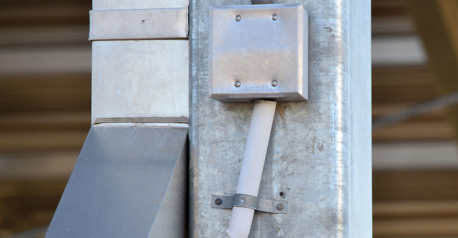

How well do you know the Code? Think you can spot violations the original installer either ignored or couldn’t identify? Here’s your chance to moonlight as an electrical inspector and second-guess someone else’s work from the safety of your living room or office. Can you identify the specific Code violation(s) in this photo? Note: Submitted comments must include specific references from the 2017 NEC.
Hint: This gives new meaning to deep knee bends.?

It’s pretty clear from this photo that the installer did not follow the old trade rule of “measure twice and cut once.” Something went horribly wrong with the measurements for the length of this raceway, which created a violation of Sec. 300.12. This Code section requires raceways to be continuous between fittings, enclosures, or outlets. Section 300.10 similarly requires metal raceways to be metallically joined together and connected to boxes, fittings, and cabinets to provide effective electrical continuity. There is no electrical continuity for this raceway installation. Section 300.3(A) generally does not permit single conductors unless installed as part of a Chapter 3 wiring method. The installer came up short on all of these Code requirements. It also appears the installer got creative with the connections on the bottom of the pneumatic valve actuator by using an RMC coupling with an FMC connector to try to establish some connection to the wiring compartment. Section 300.15 requires fittings to be used only with the wiring methods for which they are designed and listed.
