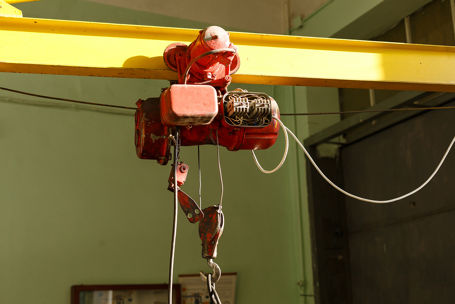

The Disconnecting Means for Cranes and Monorail Hoists
Do this to make sure your installation is compliant with the National Electrical Code
Dec. 18, 2018
Follow these rules to make sure your installation is compliant with the National Electrical Code (NEC).
You must provide a disconnecting means in the leads from the runway contact conductors (or other power supply) of cranes and monorail hoists [Sec. 610.32]. It must be lockable in the open position per Sec. 110.25, and comply with Sec. 430.109.
You can omit the disconnect where a monorail hoist or hand-propelled crane bridge installation meets all of the following:
  • It’s controlled from the ground or floor level.
  • It’s within view of the power supply disconnecting means.
  • There’s no fixed work platform for unit servicing.
And at the operating station, there must be a means for opening the power circuit to all motors of the crane or monorail hoist.
The runway conductors must also have a disconnect complying with Sec. 430.109 [Sec. 610.31]. Additional requirements for this disconnect include:
  • Readily accessible operable from the ground/floor.
  • Lockable in open position.
  • Opens all ungrounded conductors simultaneously.
  • In sight from the runway contact conductors, unless that location is impractical or more hazardous, or where written safety procedures in an industrial setting ensure only qualified personnel service the equipment.
