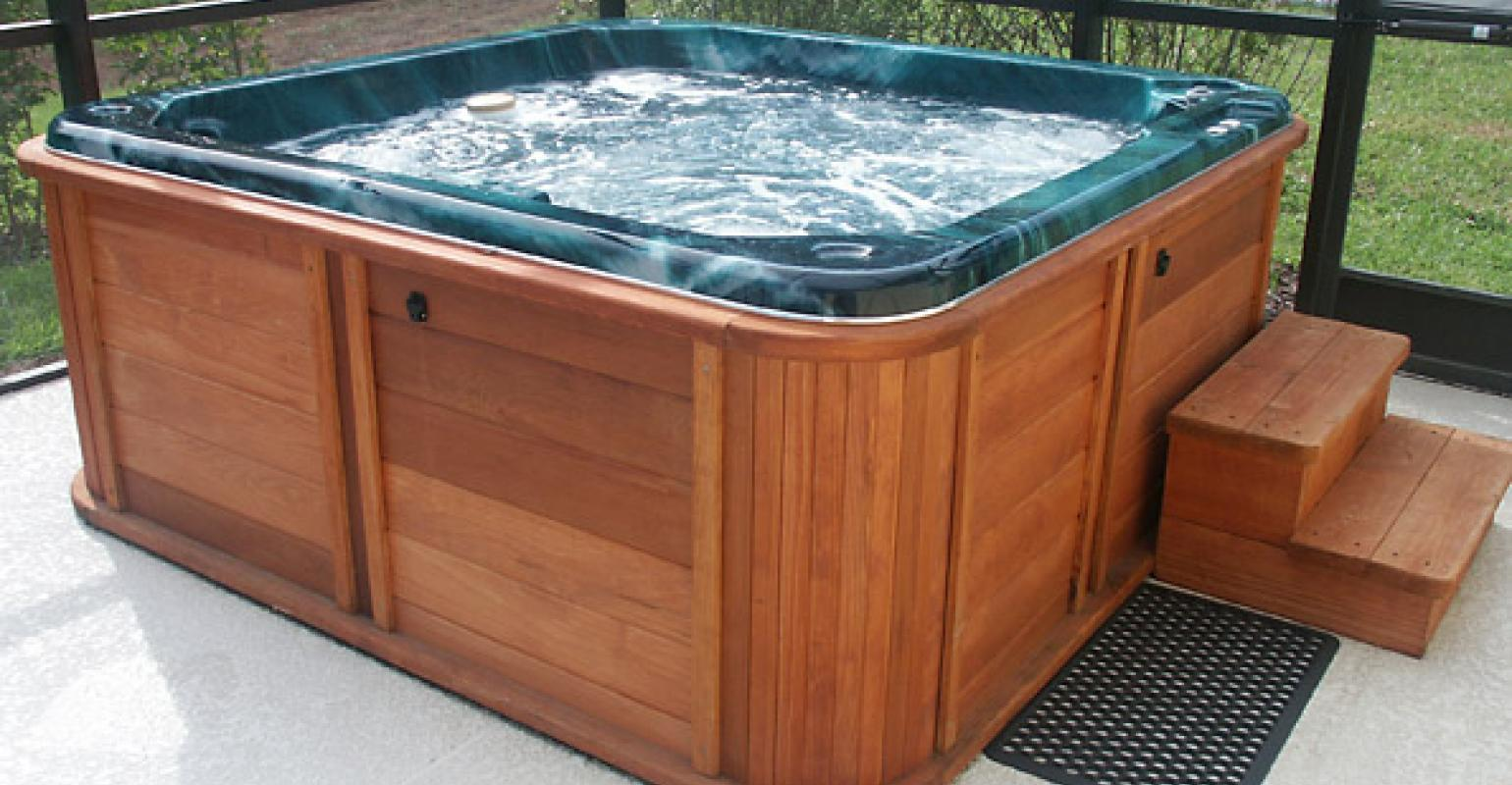

Article 680, Part VII of the 2017 National Electrical Code (NEC) provides the requirements for hydromassage tubs. Here are some highlights of what’s covered in this section of the Code:
  • The tubs and associated equipment must be on individual branch circuits and GFCI-protected [Sec. 680.71].
  • All 125V, single-phase receptacles rated 30A or less and located within 6 ft of a tub must also be GFCI-protected [Sec. 680.71].
  • All the electrical equipment must be accessible without damaging the structure or finish of the building [Sec. 680.73].
  • Section 680.74 provides a list of five types of metallic equipment that must be bonded together. The first exception note excludes small conductive surfaces not likely to become energized (e.g., water jets). The second exception note excludes double-insulated motors and blowers. So basically, if it's a conductive metal surface of any significance, you bond it. When in doubt, err on the side of caution. It is better to overdo the bonding than to leave a dangerous difference of potential.
  • When bonding, you must use a solid copper jumper that is 8 AWG or larger [Sec. 680.74(B)]. Bonding means creating a low-impedance metallic path between metallic objects; building steel and ground rods don't qualify.
