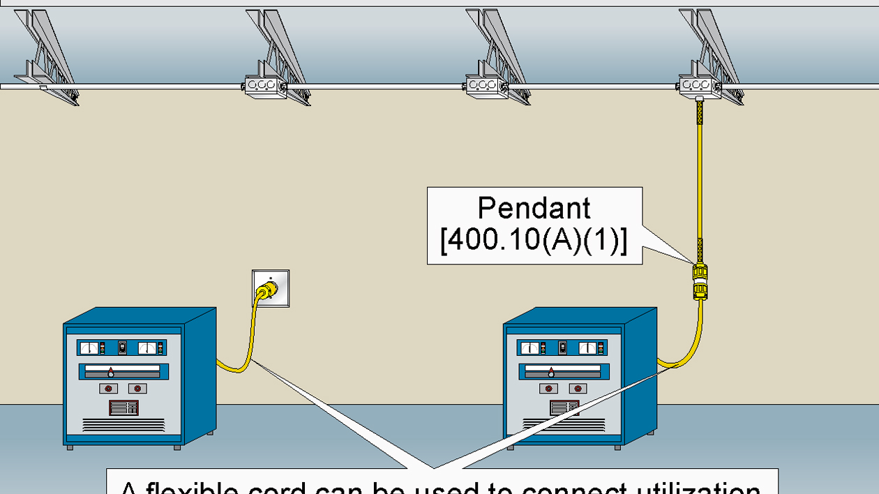

Q. What uses are permitted by the Code for flexible cords and flexible cables?
A. Flexible cords can be used for the following applications [Sec. 400.10(A)]:
(1) Pendants [receptacles [Sec. 210.50(A)] and boxes [Sec. 314.23(H)]].
(2) Wiring of luminaires [Sec. 410.24(A) and Sec. 410.62(B)].
(3) Connection of portable luminaires, portable and mobile signs, or appliances [Sec. 422.16].
(4) Elevator cables.
(5) Wiring of cranes and hoists.
(6 Connection of utilization equipment to facilitate frequent interchange [Sec. 422.16] (see Figure). 
(7) Prevention of the transmission of noise or vibration [Sec. 422.16].
(8) Appliances where the fastening means and mechanical connections are specifically designed to permit ready removal for maintenance and repair, and the appliance is intended or identified for flexible cord connections [Sec. 422.16].
(9) Connection of moving parts. Note: Flexible cords are permitted for fixed permanent wiring by Sec. 501.10(A)(2) and (B)(2), Sec. 501.140, Sec. 502.4(A)(1)(e), Sec. 502.4(B)(2), Sec. 503.3(A)(2), Sec. 550.10(B), Sec. 553.7(B), and Sec. 555.13(A)(2).
