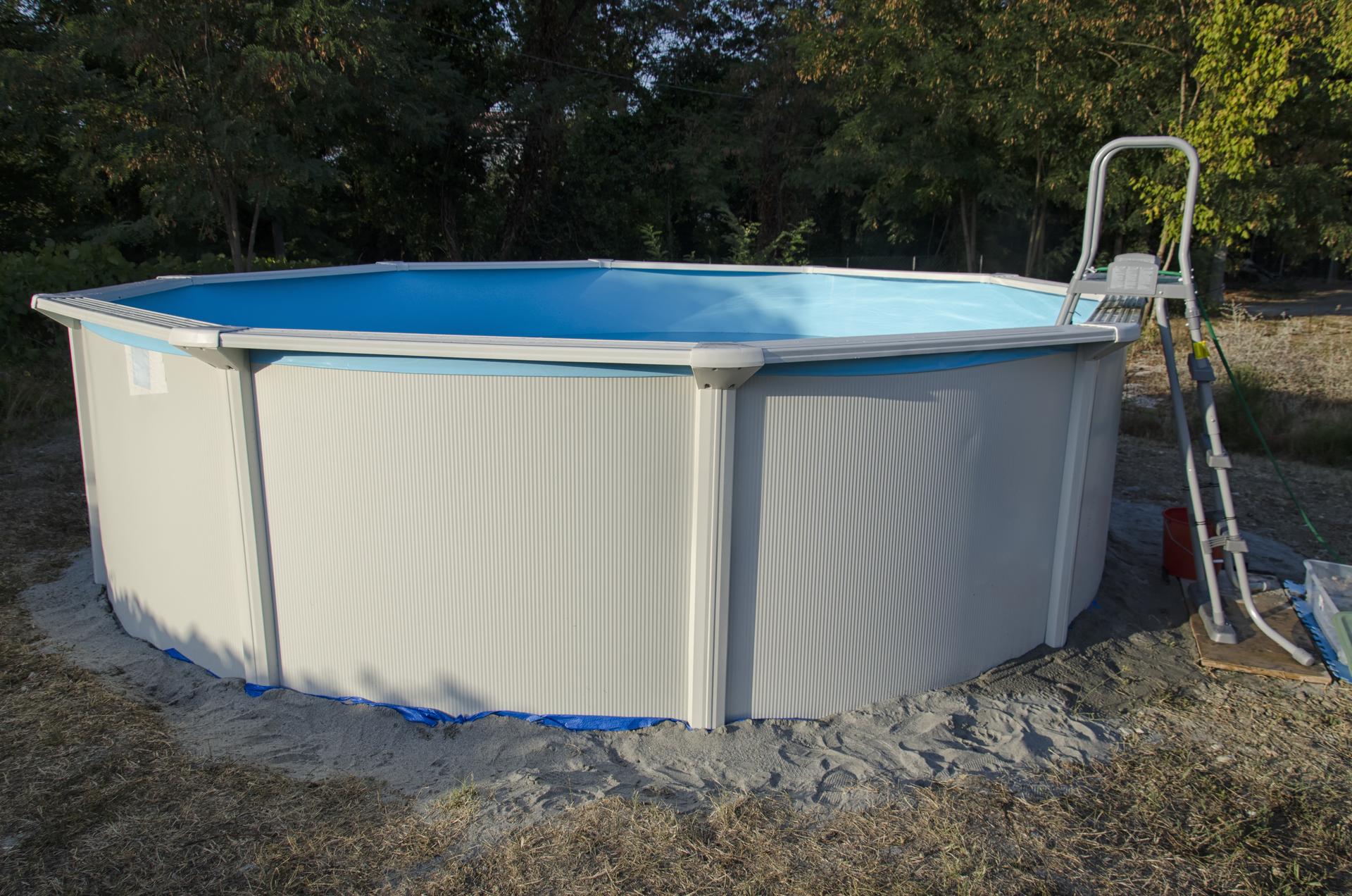

Storable Swimming, Wading, or Immersion Pools; or and Storable/Portable Spas and Hot Tubs. Swimming, wading, or immersion pools and spas and hot tubs assembled on or above the ground that are intended to be stored when not in use and are designed for ease of relocation., constructed on or above the ground and are capable of holding water to a maximum depth of 1.0 m (42 in.), or a pool, spa, or hot tub constructed on or above the ground, with nonmetallic, molded polymeric walls or inflatable fabric walls regardless of dimension.
Informational Note: Historically, a 1.0 m (42 in.) wall height accommodated most storable swimming pools. Modern manufacturing methods have allowed storable pool manufacturers to increase wall heights while still permitting ease of assembly and disassembly of the pool.
