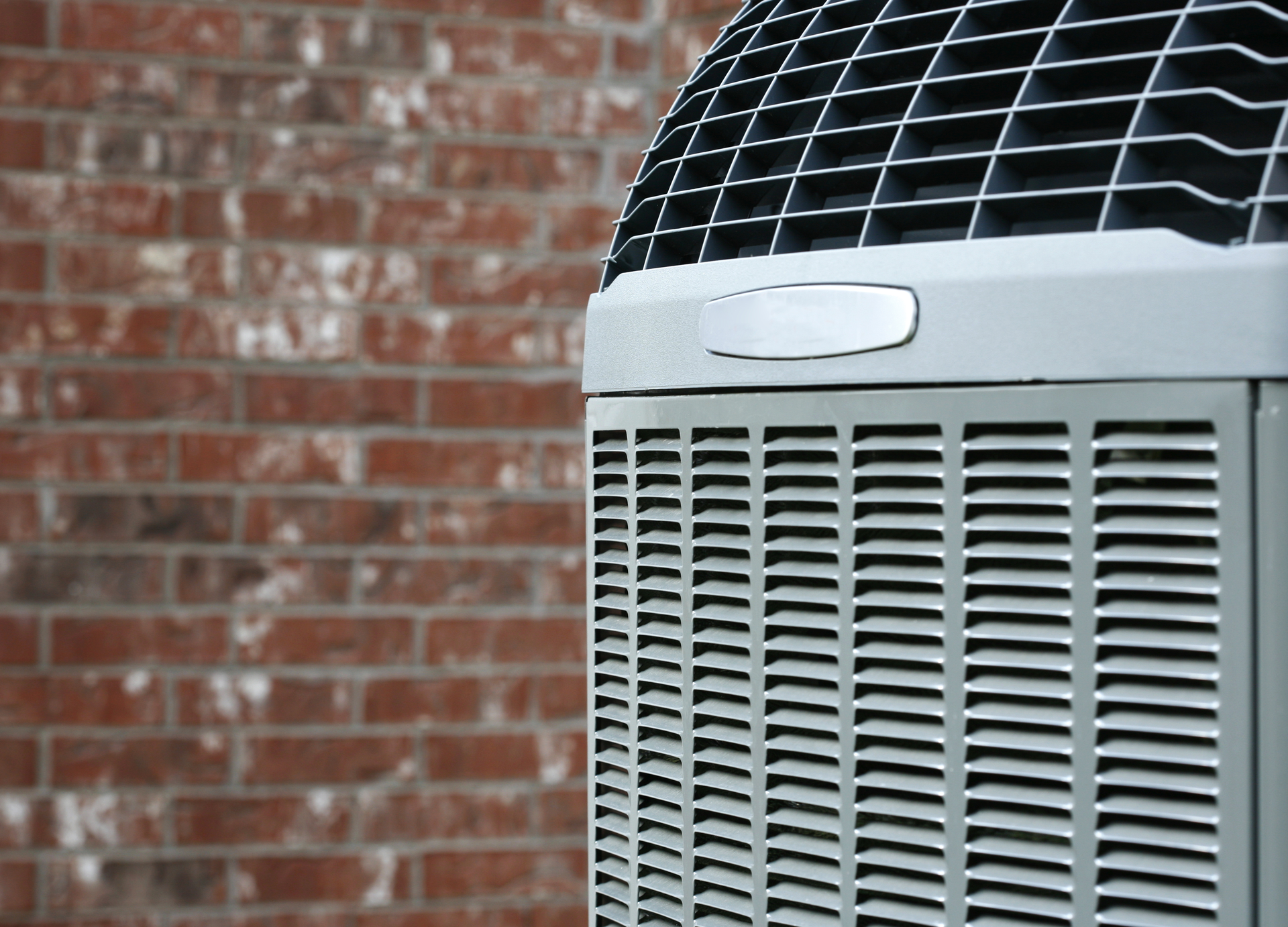

As temperatures heat up across the country, efforts by states, homebuilders, HVAC contractors, and others to sidestep a 2020 National Electrical Code (NEC) requirement linked to worrisome cases of repeated tripping of GFCI breakers on newly installed HVAC units have been following suit.
Of concern is Sec. 210.8(F), new to the 2020 Code, which extends GFCI protection to outdoor outlet components of air-conditioning and heat pump systems and other equipment supplied by single-phase branch circuits rated 150V to ground or less, 50A or less. The impetus for the extension of GFCI protection to such equipment came largely from the 2007 electrocution death of a 12-year-old boy who jumped a fence and contacted an A/C condenser unit that had an electrical ground fault to the metal fence.
Beginning last year, some jurisdictions that adopted the 2020 edition of the NEC, or were poised to, discovered the chronic tripping problem, tracing it to GFCI device incompatibility with certain types of HVAC equipment. Reports from builders, contractors, and inspectors of A/C units repeatedly shutting off, robbing homeowners of the ability to reliably control dwelling temperatures, and, in turn, exposing them to health risks as the summer cooling season arrives, have led several bodies to remove, alter, or postpone enforcement of Sec. 210.8(F) in their jurisdictions. To date, however, review committee procedures of The National Fire Protection Association (NFPA), the body that develops NFPA 70 (i.e., the NEC), have rejected proposals to change the Code’s requirement.
One of the first jurisdictions to discover and detail the tripping problem last year was Shelby County, Ala., and its then chief electrical inspector. He was the first to submit a formal Tentative Interim Amendment (TIA) with NFPA in September to address the issue. The TIA, ultimately rejected by NFPA, sought to postpone the effective date of Sec. 210.8(F) until Jan. 1, 2023, citing recent field experience with new installations demonstrating “random opening of the GFCI devices protecting ductless mini splits and (possibly) other (AC) equipment employing power conversion equipment controlling the speed of the compressor.”
Since then, more evidence has accumulated that a range of A/C and heat pump units employing certain control technologies and commonly used in new home construction do not work with GFCI circuit breakers. That prompted several other 2021 TIAs (1589, 1564, and 1593) calling for postponement; some of which were rejected and others the NFPA’s standards committee is slated to consider at its August meeting.
