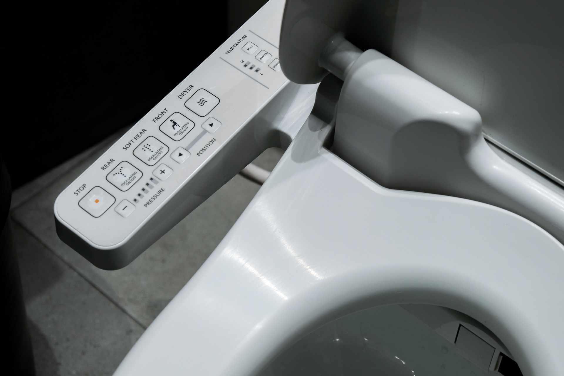

Exception No. 2: In a dwelling unit, a single receptacle shall be permitted for an electronic toilet or personal hygiene device such as an electronic bidet seat. The receptacle shall be readily accessible and located on one of the following:
(1) The wall behind the toilet but not behind the tank
(2) The opposite side of the toilet from the bathtub or shower
Substantiation: It is quite common for a toilet to be located next to a bathtub or shower in a residential bathroom. The existing text in NFPA 70 could prevent the installation of a receptacle that is necessary for the operation of an electronic toilet (also known as a “smart toilet”) or personal hygiene device (e.g., electronic bidet seat) where a toilet is located within 3 feet horizontally of a bathtub or shower. Application of the receptacle placement requirements has the potential to place an undue burden on the consumer whereby additional cost may be incurred to position the receptacle in an acceptable location without considering potential structural barriers behind the wall that may further restrict installation. Therefore, the proposed exception is necessary to ensure that such plumbing products are permitted to be installed while not jeopardizing the level of electrical safety that the standard seeks [see below photo(s)/diagram(s) that provide clarity for the proposed exception]. As such, due to the proximity of the individual receptacle to the bathtub or shower, it would be required by NEC Section 210.8(A)(9) to be protected by a Class A GFCI device minimizing any potential shock hazard. Moreover, it is our understanding that products like electronic toilets and personal hygiene devices were not taken into consideration during the discussion of the proposal prior to adoption into the current standard.
