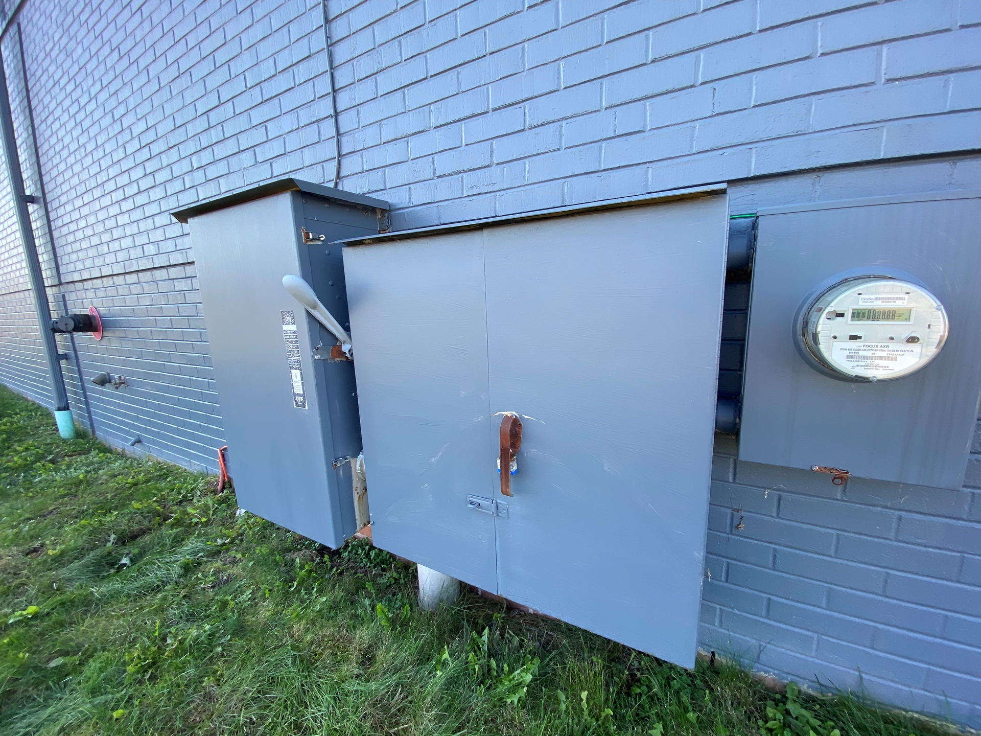

    Standard (U.S.) voltage systems for electrical services
    Here in North America, our standard voltage system(s) provided by the electric utility companies on the secondary side of their transformers are:
    • 120/240V single-phase service (three-wire system): residential homes, multi-family dwellings, small commercial buildings
    • 208/120V three-phase wye system (four-wire system): multi-family dwellings, commercial buildings, light industrial buildings
    • 480/277V three-phase wye system (four-wire system): multi-family dwellings, commercial buildings, industrial buildings and plants
    • 600/480V three-phase delta system (four-wire system): industrial buildings and plants (manufacturing facilities)
     Older additional systems still in service in some areas:
    • 240/208/120V three-phase (high-leg four-wire wye system): Commercial Buildings, Light Industrial Buildings
    • 120/240V two-phase (four-wire system): Commercial Buildings, Industrial Buildings and Plants

    Running service conductors through a building
    An electrical contractor may need to relocate a main electrical service to a more suitable location for various reasons. Sometimes, this is required to avoid installing the service equipment in an area that floods or simply placed in a location where it's more accessible for all tenants. This situation is typical in residential new construction homes to hide the service equipment away from the building's facade. This situation may require the electrical contractor to run service conductors through a building. This type of installation is permissible under the following conditions. The conductors must be protected in a reinforced manner; they must be considered outside the building. The conductors must be installed in not less than 2 in. of concrete beneath a building or other structure; additional guidelines may apply to any raceways or conductor insulation types used. The conductors must be installed in a raceway that is encased in concrete or brick at least 2 in. thick.
