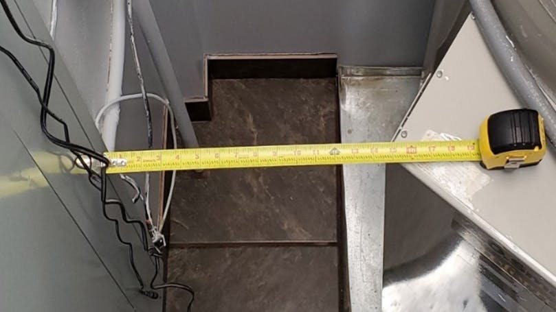

The commercial water heater in Photo 1 is only 15 in. from the front of the electrical panel. The NEC requires at least 36 in. of “clear” working space. In addition, the plumbing code (IPC Sec. 502) states: “Electrical water heaters shall conform to the requirements of this code and provisions of NFPA 70 (the National Electric Code).” This is the cross/code element.
This installation is a triple fail. First, the plumber should have complied with the requirements in the NEC. Second, the electrician should have been involved in energizing the water heater, and they should have seen the Code violation. Third, this installation should have required a permit and inspections. The inspector should have been all over this non-code-compliant installation.

Photo 2 demonstrates another violation of the dedicated space rule. A natural gas line for a gasoline station is only 17 inches from the electric trough. At rough-in, it was not obvious that the gas line was going to be in the dedicated electrical space.
This NEC violation was discovered during the temporary to permanent inspection. It is a violation of Sec. 110.26E(2)(b), which has the same 36- and 30-inch requirements as Sec. 110.26(A). In this situation, the builder had to (reluctantly) relocate the natural gas line. He was not happy about it because “technically” the trough and panels were placed after the gas line was placed — and after the sidewalk was poured.
As an electrical inspector, this does not matter. The installation as completed violated the NEC. We don’t care who was there first. The final product is what matters. In this case, the power cannot be turned on until the gas line is moved out of the dedicated electrical space. This failure was due to the construction superintendent not watching what his subcontractors were doing. His lack of planning and supervision does not relieve him of complying with the code requirements.
