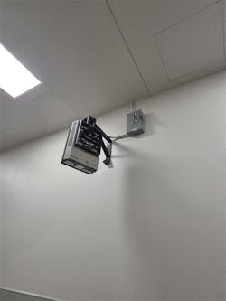

Section 240.24(A)(4) and Sec. 404.10(A), Exception No. 2 relates to equipment co-located with utilization equipment. They permit devices adjacent to the utilization equipment they supply to be mounted higher than 6 ft, 7 in. and accessed by portable means. This means if a device is near the equipment it protects, it does not necessarily have to be permanently and readily accessible; portable access, like a ladder or lift, is acceptable. This clause provides flexibility in installations where permanent accessibility might be impractical, as long as the device is still reasonably reachable when needed (Photo 1).

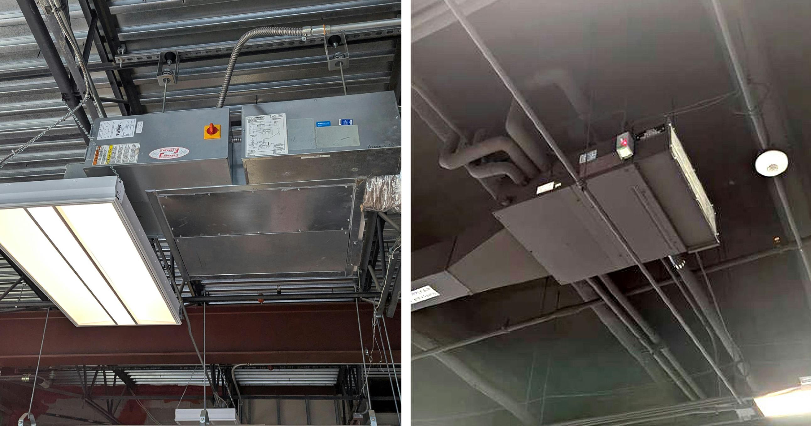

These NEC Articles provide flexibility for installations in non-standard locations, such as above accessible drop ceilings or in elevated positions. It allows switches and circuit breakers used as switches to be mounted above the standard height of
6 ft, 7 in., provided they are installed adjacent to the equipment they serve and are accessible by portable means (e.g., ladders). This exception is especially relevant in scenarios where aesthetics or space constraints necessitate overhead installations. Understanding and applying this provision ensures Code compliance while accommodating practical design and architectural considerations (Photo 2).

In general, the NEC requires electrical equipment to be located such that it has a minimum working space of approximately 30 in. wide (or the width of the equipment), 6 ft, 6 in. high, and 3 ft to 5 ft deep, and requires that switches and overcurrent protective devices be located no higher than 6 ft, 7 in. However, exceptions abound. Where equipment is installed adjacent to the equipment it supplies (e.g., ceiling-mounted heating, ventilation, and air-conditioning equipment; equipment installed in specific locations with irregular access), the NEC permits alternative working space dimensions and installation criteria.
