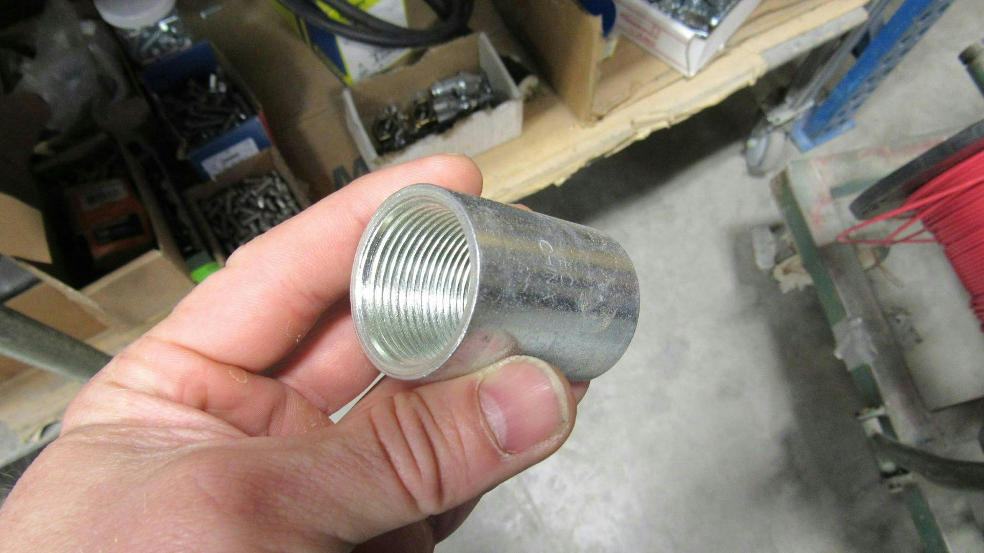

Tightening all fittings: Sec. 342.42
Before the 2026 revision, Sec. 342.42 focused on threadless fittings, requiring them to be tightened properly and to be concrete-tight when installed in masonry and listed for wet locations when applicable. The revision broadens this language to include all couplings and connectors, not just threadless types. This includes threaded fittings like unions and three-piece couplings. The requirement to make all fittings up tight and to ensure listing for the relevant environment emphasizes the importance of secure, Code-compliant connections. This same update appears in Sec. 344.42. It is important to note that a straight thread coupling is not listed as a fitting; it is listed as part of the conduit itself. These couplings are not required to be listed for wet locations because the conduit itself is permitted in wet locations, and the coupling is just part of it.
