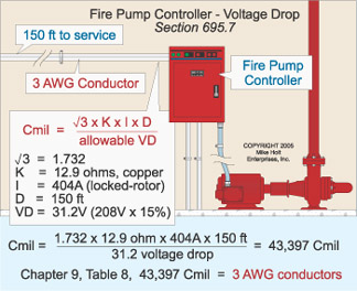

Now it's time to test your knowledge with this problem. A 25-hp, 208V 3-phase fire pump motor is 175 feet from the service. The fire pump motor controller is 150 feet from the service. What size conductor must you install to the fire pump motor controller? Equipment terminals are rated 75°C (Fig. 1).
Rearrange the basic voltage drop formula for a 3-phase system into this new formula:
Cmil=(1.732×K×I×D)÷VD
Use the following values when making your calculation.
K=12.9 ohms, copper
I=404A (locked-rotor, Table 430.251B)
D=150 feet
VD=31.2V (208V×15%)
Plug these values into the formula and reference the appropriate NEC table to obtain your answer.
Cmil=(1.732×12.9 ohms × 404A × 150 ft) ÷ 31.2V
Cmil=43,397
As per Chapter 9, Table 8 of the NEC this particular arrangement calls for a 3 AWG conductor.
