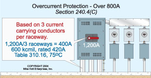

    Over 800A
    If the OCPD exceeds 800A, the conductor ampacity (after ampacity adjustment and/or correction) must have a rating not less than the rating of the OCPD. For example, a 1,200A OCPD can protect three sets of 600kcmil conductors per phase, where each conductor has an ampacity of 420A at 75°C per Table 310.16 (Fig. 1).
