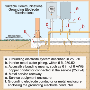

Electrode locations.
Where do you make this earth connection? Any of the following are suitable as a ground for communications equipment [800.40(B)(1), 810.21(F), 820.40(B)(1), and 830.40(B)(1)] (Fig. 1 on page 72).
  • The building or structure grounding electrode system (250.50).
  • The grounded interior metal water piping system within 5 ft of the point of entrance into the building (250.52).
  • The power service accessible means external to enclosures (250.94).
  • The metallic power service raceway.
  • The service equipment enclosure.
  • The building or structure grounding electrode conductor or the grounding electrode conductor metal enclosures.

A grounding electrode for communications systems must be bonded to the building or structure grounding electrode system with a 6 AWG copper or larger conductor [800.40(D), 810.21(J), 820.40(D), and 830.40(D)].
The grounding of power and communications systems to the same single-point ground reduces the voltage potential differences between systems. This becomes crucial where these different systems are integrated (Fig. 2 above).
Termination fittings encased in concrete or buried in the earth must be listed for direct burial and marked “DB” [800.40(C), 820.40(C), and 830.40(C)]. You must terminate ground conductors to the grounding electrode with exothermic welding, or a listed lug, pressure connector, or clamp.
