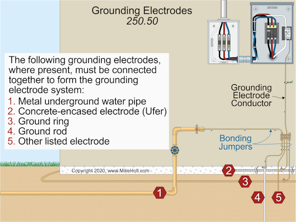

Fig. 1. To create a grounding electrode system, you bond the various electrodes that are present.
