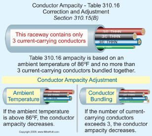

Fig. 1. When determining conductor ampacity, remember the allowable ampacities listed in Table 310.16 are affected by conductor insulation, ambient temperature, and conductor bundling.

Conductor ampacity
The ampacity of a conductor is the rating (in amperes) that a conductor can carry continuously without exceeding its insulation temperature rating [Art. 100]. The allowable ampacities listed in Table 310.16 are affected by conductor insulation, ambient temperature, and conductor bundling [310.10 and 310.15(B)] (Fig. 1).
Section 110.14(C)(1)(a) states that terminals are rated 60ºC for equipment rated 100A or less, unless marked 75ºC. Although most terminals are now rated 75ºC, be careful of assumptions —some equipment is still rated 60ºC. Always read the specifications and manufacturer's labeling information carefully to know what you're working with. If in doubt, be sure to use the rules of 110.14(C).
