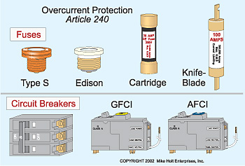

Protecting circuits and equipment from overcurrent from overcurrent involves more than simply selecting a fuse or breaker from a table Art. 240, which is divided into seven parts, provides the requirements for selecting and installing overcurrent protection devices (OCPDs) (Fig. 1). Before addressing those requirements, let's review the basic concept of overcurrent protection. When current exceeds

Art. 240, which is divided into seven parts, provides the requirements for selecting and installing overcurrent protection devices (OCPDs) (Fig. 1). Before addressing those requirements, let's review the basic concept of overcurrent protection. When current exceeds the rating of conductors or equipment — due to overload, short circuit, or ground fault — you have overcurrent (Fig. 2 below). To protect conductors and equipment, you use OCPDs.
An OCPD protects equipment by opening when it detects an overload, short circuit, or ground fault. Every piece of electrical equipment must have a short-circuit current rating that permits the OCPD to clear short circuits or ground faults for that equipment without extensive damage to the circuit's electrical components (110.10). You must also apply the other Articles referenced in 240.3, depending on the equipment you're protecting.
An OCPD protects a circuit by opening when current reaches a value that will cause an excessive temperature rise in conductors. The OCPD interrupting rating must be sufficient for the maximum possible fault current available on the line-side terminals of the equipment (110.9). You'll find the standard ratings for fuses and fixed-trip circuit breakers in 240.6. The ampere rating of an adjustable circuit breaker is the maximum possible long-time pickup current setting permitted. A circuit breaker with restricted access to the adjusting means can have an ampere rating equal to the long-time pickup current setting.
You must protect conductors against overcurrent, based on the ampacities in 310.15. As you might expect, this rule has exceptions. First, it doesn't pertain to flexible cords, flexible cables, or fixture wires. Second, 240.4, Parts A through G, provides an extensive list of “otherwise permitted” items. These include fire pumps (A), tap conductors (F), and an extensive table of specific conductor applications (G).
