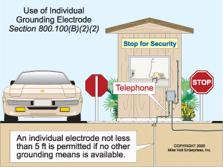

In a structure without a grounding means, install a ground rod not less than 5 feet long and ½ inch in diameter. Then bond the grounding conductor to it [800.100(B)(2)(2)] (Fig. 1), using a minimum 6 AWG conductor [800.100(D)].
